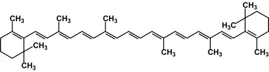

Conjugation:
This term is used to describe a system of continuous, overlapping p-orbitals where electron delocalization can occur. Examples of conjugated systems include the 1,3-butadiene, acrolein, benzene, beta-carotene, etc.
Conjugate systems beta-Carotene

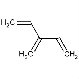

Cross-conjugation:
Sometimes you'll hear the term "cross-conjugation" used. In this case, the continuity of the overlap between the p-orbitals does not follow a simple linear pattern as seen in the examples of conjugation pictured above. Benzophenone and 3-methylene-1,4-pentadiene are examples of molecules with cross-conjugation.
Benzophenone
2-Vinyl-1,3-butadiene
