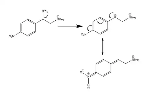

I read an amazing PDF from nptel on elimination reactions...but I was really confused when it used used $\ce{^+NMe3}$ as a leaving group in the reaction pathway via:
  • $\mathrm{Ei}$ (syn-elimination)
  • $\mathrm{E2}$ (anti-elimination)
  • And also, in an illustration for $\mathrm{E1_{cb}}$.
My organic chemistry teacher also did syn-elimination but in the problem solving book and on various online sites it took the $\mathrm{E2}$ elimination pathway.

The Hoffman elimination is nost often an E2 elimination (as in your last example), as the comments already mentioned. There are many resources that go into greater depth about the reaction.
The "counterexamples" that you gave can all be explained, but they are not peculiar to Hoffman elimination. The same outcome could be observed with a different leaving group, I believe.
The E1cb elimination happens, because the intermediate carbanion is very stable - it is stabilized by the nitro group and the benzene ring (and also the inductive effect of the trimethylammonium group.
The Ei elimination happens due to the constraints on the geometry of the ring. As you can (hopefully) see on the picture below, the substitutents are forced into an almost eclipsed configuration. Therefore, there can be no anti-periplanar elimination, simply because no bond is anti-periplanar to the C-N bond being broken. The best orbital overlap is therefore reached with the (more or less) syn-periplanar C-D bond, which is therefore the broken one.
