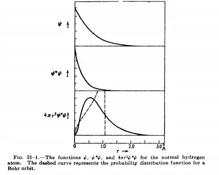

This is an excerpt from Linus Pauling's book:
the most probable distance of the electron from the nucleus, which is the value of $r$ at which $D(r)$ has its maximum value, is seen from Figure 21-1 to be $a=\pu{0.529 \mathring{A}}$, which is just the radius of the normal Bohr orbit for hydrogen.
[Figure 21-1 is the Radial Probability Distribution Curve (RPDC) for the 1s orbital, see below.]
And on the next page he states that:
The function ${\psi^2_{100}}$ has its maximum value at $r=0$, showing that the most probable position for the electron is in the immediate neighborhood of the nucleus; that is, the chance that the electron lie in a small volume element very near the nucleus is larger than the chance that it lie in a volume element of the same size at a greater distance from the nucleus.
Don't these two statements contradict each other? $\psi^2$ versus $r$ says that the probability density is highest at $r=0$. RPDC says that the probability is highest at $r=\pu{0.529 \mathring{A}}$. Why is there such a stark difference between probability density and probability? When $r$ tends to $0+$ we observe high electron probability density (wrt the $\psi^2$ curve) but minimized electron probability (wrt the RPDF curve)
I do understand, however, that Radial Probability Distribution Curve represents probability and $\psi^2$ versus $r$ represents probability density. But why is there a difference in these two?
For reference:
