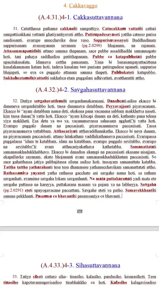

Maybe you know this already.
It's quoted in this document:
Here's a screenshot of the page:

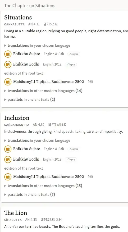

According to that it's AN 4.32 i.e. after AN 4.31 (Cakka sutta) and before AN 4.33 (Siha sutta).
Here are those on suttacentral:
But the Pali text translated in AN 4.32 on Suttacentral isn't the same (and is much shorter).
