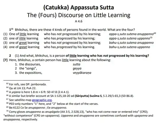

I'm confused too though, by this. Below is Piya's rendition of AN 4.6. Note that:
  • The Pali is given as uppanno
  • The footnote says it's sometimes confused with upapanno
In contrast, below is Ven. Sujato's rendition of AN 4.6. Note:
  • The Pali is given as upapanno (contradicting the Pali in Piya's version)
  • The translation "get the point of learning" (which is perhaps more literally "learning comes into existence") contradicts Ven. Sujato's own comment that upapanna always refers to rebirth, so I don't know what's happening there
What four? A person may have:
Katame cattāro?
  1. Little learning and not get the point of learning.
  2. Little learning but get the point of learning.
  3. Much learning but not get the point of learning.
  4. Much learning and get the point of learning.
    Appassuto sutena anupapanno, appassuto sutena upapanno, bahussuto sutena anupapanno, bahussuto sutena upapanno.
I don't know anything about why there are different versions of the Pali, except that apparently there are. Maybe it's what Ven. Sujato was talking about in the first quote:
Ñāṇānanda refers to the reading anuppanno. This is the mainline reading of the PTS edition, and is presumably supported by the Sinhala manuscripts. The Burmese texts have anupapanno.
See also the quote appended to the OP:
it is almost impossible to distinguish between upap˚ and upp˚ in the Sinhalese writing
Confusing! Maybe you can derive some kind of clue from other bits of this answer though.
