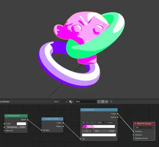

  • I think you are going to love the new "Shader to RGB" node in Eevee: https://youtu.be/10I2eWm7z70 As for Cycles, it appears that the Compositor is the only way to control such things. You can do a shadow pass and adjust color in compositor, maybe even try Cryptomatte which can auto output all materials and objects for separation and masking etc in compositing. – Coby Randal Feb 28 '19 at 20:39
  • For quick reference, Cryptomatte and Shader to RGB node (Eevee only) are both available in Blender 2.80, not 2.79. I just saw another video on shadow color edits with Shader to RGB node. So cool! https://youtu.be/t91X4eukZY4 – Coby Randal Mar 05 '19 at 18:05

Eevee
Just an illustration of Coby Randal's comment - Shader to RGB node.
In case you want to keep AO ...
Note: I wanted to composite AO pass (instead mix it in shader), but with this shader is AO pass wrong for some reason.

I haven't found a way to change the color of shadows with only materials in cycles, I mean there is a way, but by doing so all shadows made by that object will be tinted (either on itself and that would include the background). A more controlled way would be by using the compositor in post, production.
You can't change the color of the shadows directly as far as I know, but via compositing you can. Try messing with a color balance node and see if it is to your liking. https://docs.blender.org/manual/en/latest/compositing/types/color/color_balance.html
edit: actually, if you are willing to switch to eevee, you might be get more control over your shadows. https://www.youtube.com/watch?v=t91X4eukZY4 Here is the tutorial I followed, except I didn't split the RGB, didn't use a diffuse shader to modify the base, and just simply used a color ramp with the different colors I wanted for the shaders. Try it c:
