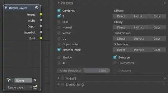

Also can you please try looking at the node setup from the tutorial page. and explain a few things. Image 2
This image is on photobucket so I cant see a high res image. You all must be experienced to guess a few things. Both of my render layers nodes are of same size but here, the first layer(planet) seems to have more options on its nodes. There are even 2 outputs from that layer.

I guess you are confusing some concepts here. You CANNOT combine the results you "save" in different render slots in the composite. (Unless you save them to a file and import them later on. But that's not what you want to do here.) These Slots are mostly for comparing versions/settings of your render.
What you want to do, however, is add another render layer. (look at the right in your screenshot.) Use the [+]-Button to add a new render layer. You need separate layers for the planet and the atmosphere.

EDIT (answering the additional part of your question)
1)
To get more outputs from the first node, you need to select more render Passes for the render Layer, like so:
outputs
Here I selected all of them, just to show you. However, to get the node, as seen in the Screenshot, just select "Emission".
The rest seems to be unnecessary. But I selected them as well, just to show you. (Note: Z = Depth in the current version of Blender)
