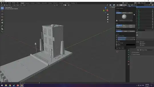

Now in blender 2.92 is in the shading menuenter image description here
