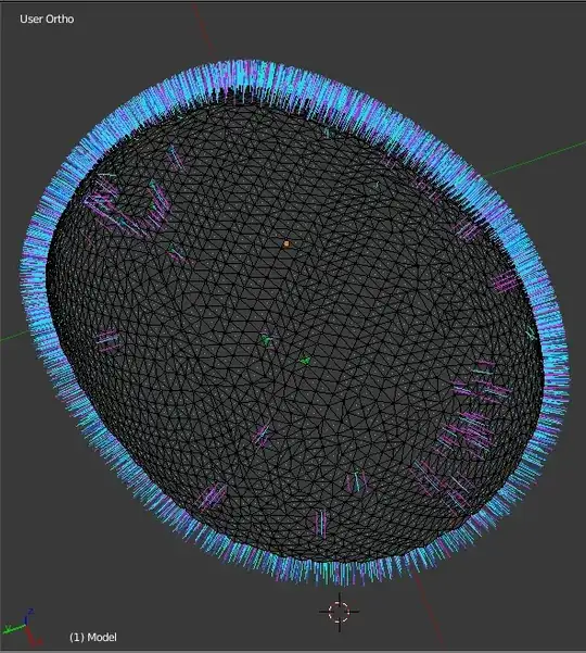

However, looking from the inside shows that some faces are facing inwards, causing problems for another program along to process:
Inside showing some normals are incorrect
The scanner seems to double up some faces causing these problems. I can get away with deleting the erroneous faces/vertices (leaving holes to be filled in blender or the next stage), but I can't figure a way to detect these areas and remove them.

Close up of one of the problems:
