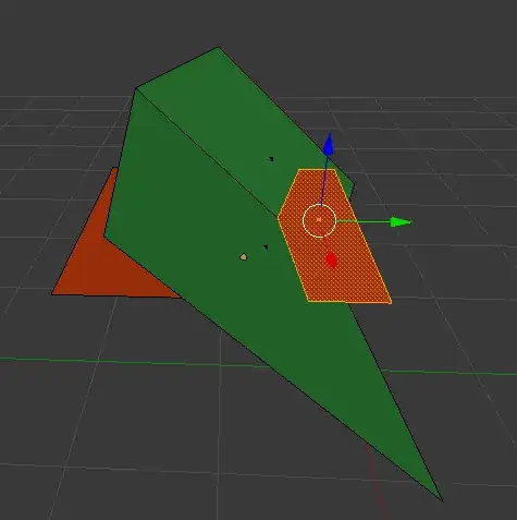

As a small example, I have two intersecting faces, both part of a larger object. Without destroying the textures, I'd like to connect them (so they share vertices) where they intersect. That way I can create edges and delete whatever sections I wish to remove. Here is a small example:
example
My cumbersome method so far is to subdivide an edge, slide the vertex to where it looks like it meets, draw new lines, delete original faces, create new faces, and remap the UV. Is there an easier way?
Below is a larger example. The following link is a small piece of my blend project of which I'm trying to do this maneuver on. In short, I want to remove all the green on the inside of the brown and all the brown on the inside of the green. I hope that makes sense :-)

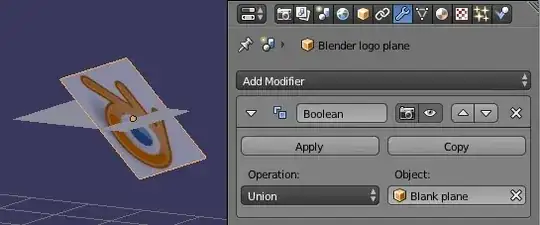

  2. Add a Boolean modifier to each plane:
    Select plane → Object Properties panel → Modifiers tab → Boolean
    • Set the Operation to Union or Intersect
    • Set the Object to the other plane
    For example, here is the modifier added to the "Blender Logo plane": enter image description here
    And here is the modifier on the "Blank plane": enter image description here
  3. Click the Apply button on both modifiers
