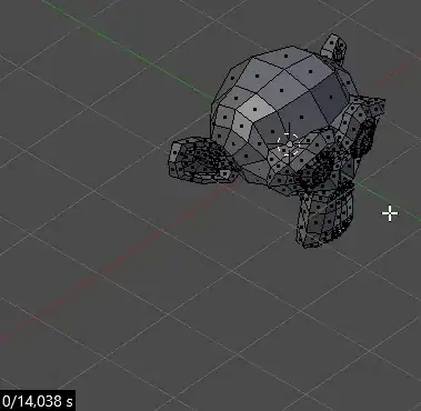

As far as I understand you can not do that, but you can use the knife tool to make cuts on the surface, to access the tool touch the k or in the t menu on the left side of your screen in edit mode. also remember that if two sides are very close to each other it will give the illusion that the area is flatter
here I leave you an image as an example
