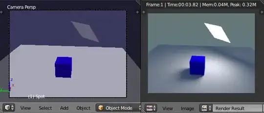

One of the biggest differences between lighting you scene with a lamp and a mesh with an Emission Shader is that a lamp will provide light in you scene, but the light source itself (the lamp) will NOT be visible in your render. For example, in the scene below, you can see the spotlight lamp in the 3D Viewport, but on the right, when the scene is rendered, you can see the lamp's light in the scene, but the lamp itself is not visible at all:
