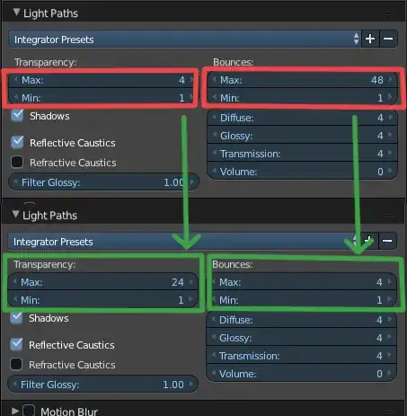

It won't let me post another pic yet as I'm new to the forum but my settings are as follows: Transparency Max:4 Min:1, Bounces Max:4 Min:1, Diffuse:4, Glossy:4, Transmission:4, Volume:0, Shadows: Checked, Reflective Caustics: Checked, Refractive Caustics: Not checked, Filter Glossy:1.0,

    Looks like some of the rays are being terminated before reaching a light source or lit surface: how many transparency bounces did you set? could you show you light path panel? – Carlo Apr 17 '17 at 22:23
  • increase the number of transparency bounces: https://blender.stackexchange.com/questions/42023/transparent-textured-planes-produce-black-artifacts/42026#42026 and https://blender.stackexchange.com/questions/27718/black-artifacts-when-looking-through-many-transparent-objects/27719#27719 –  Apr 18 '17 at 02:54
By increasing the Transparency Max from 4 to 24 (with some trial and error), I was able to successfully eliminate the all of the shadows from my animation. I originally tried increasing the Bounces Max to 48 with no success, so I dropped it back to 4, then increased the Transparency Max amount and everything worked.
Thanks to everyone for their help and suggestions.
