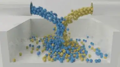

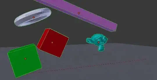

Another way to do this is using @Jacques Lucke's Animation Nodes addon. Here is the final result:
And here is a picture of the node setup:
This is done with a Rigid Body Simulation and Vertex Colors. After installing Animation Nodes (linked above), we can get to work.

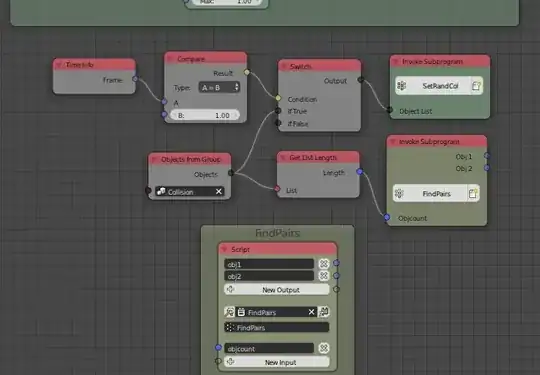

In the node window, click on the Animation Nodes. Add an Objects From Group node (to add a node, either press Shift + A and find the node, or press Ctrl + A to search for it). Select the Group.
The first thing we want to do is to assign random colors to each object on Frame 1. Let's create a subprogram to do that. Add a Loop Input node and name it SetRandCol. Press the + button next to New Iterator and type "Object List". Set up the following nodes:
To activate the loop, add an Invoke Subprogram node, select SetRandCol, and plug in the Object list. It should take effect immediately.
We don't want this to happen every frame, though. Just the first. Add these nodes to make it only work on Frame 1:
Cool. The next step is to calculate all of the different pairs of objects we will have to check collision against. We could do this with nodes, but it is faster to just use a short script. First, add a Get List Length node and plug in the Object list. Next, add a Script node and name it FindPairs. Press the + button to add a new script. Use the buttons to add 1 input (an integer) and 2 outputs (integer lists). Name them as follows:
In a Text Editor window, open the FindPairs script and paste the following:
obj1, obj2 = [],[]
for i in range(0,objcount):
for j in range(i,objcount):
if i != j:
obj1.append(i)
obj2.append(j)
To use the script, add an Invoke Subprogram node and select the "FindPairs" option. Plug the Get List Length node into the script node. obj1 and obj2 are all the pairs of objects (i.e. index 0 goes with index 0, etc).

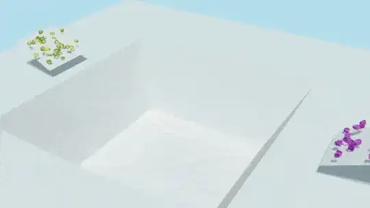

Incorporating the Molecular Modifier has a similar workflow to the Rigid Body Method. Begin by setting up a Molecular simulation. Here is mine:
Node setup:

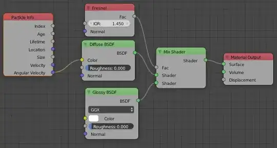

After setting up the molecular simulation, we can work on the coloring. To color the particles, we are exploiting a feature of the Molecular Modifier: since the entire simulation is baked with its own physics, the particles never rotate and therefore never use the Angular Velocity attribute. We will store our colors there. Set all of the particles to render as an Icosphere object and give the Icosphere this material:

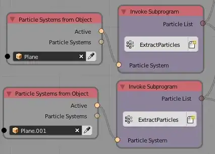

Now that we have that set up, we can get on to coloring the particles. For each of our particle emitters, add a Particle Systems from Object node. Add one of our ExtractParticles nodes for each Particle System:
