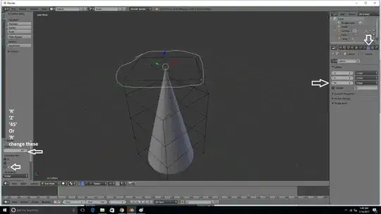

There are many ways to do this, but the one I found to be the easiest was to use a lattice. First, make a cone (go to and scale it to the desired size. enter image description here Next, create a Lattice object and add a lattice modifier to the cone. Make sure to scale the lattice so that the cone fits inside it. Also make sure to add the modifier to the cone, and not the lattice. enter image description here Next, connect the lattice to the cone by adding the lattice to the modifier under objects. Also subdivide the cone in edit mode (press 'tab') to make it smoother. enter image description here Switch to the lattice and change its W value to 5 (great value=smoother horn). Go into edit mode and select all the vertices on a 'level' (same z position). Press 'r' then 'z' then enter how much you want to rotate the horn by. enter image description here Rotate the rest of the 'levels' of vertices at intervals (45,90,135,etc.). More than likely your cone might look a little off until you're finished rotating all the vertices. When you are done, to make it look smooth, add the sub-surf modifier. To avoid crashing blender, don't set sub-surf higher than 4-5 (mines at 2). enter image description here You can also use the sculpt tool to add more detail (a lot of videos/ articles on how to sculpt).
