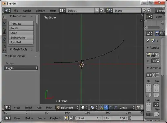

You could make a bent line in the XY plane for example (1), a subdivision surface modifier and use a screw modifier (2) with
  • screw : 0
  • steps : as you like
  • angle : 360
(1) enter image description here
(2) enter image description here
