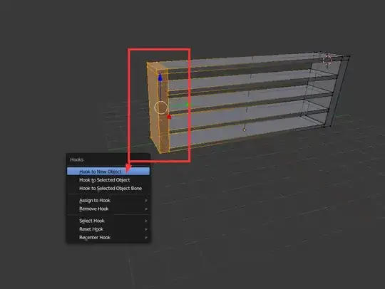

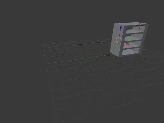

If I got it right, what you could do is using hook to move one side of the shelf, like this
  1. In edit mode, select all vertices of one side of the shelf, then, hook (CTRL+H) them to an empty like this
  1. then you can select the empty
  1. and moving it (here on Y) will "scale horizontally" your shelf like this:
Other setups are possible, this is just to give you the idea

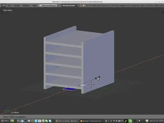

I add this as another answer, instead of editing the above, because the method is completely different, more complete but also way more complex... you could choose this or the other method (or some other too) depending on different desired usage...
That said, this method:
  • use separate meshed instead of a single one
  • involves several and complex parenting and contraints
  • allows "shelf scaling" on any axes X,Y,Z
  • provides a separate "driver" mesh to enable the scaling on the "shelf" object
Because of the complex setup and being composed of separate meshes, this could be difficult to manipulate as a whole single "shelf" object... imho.
This is the example "shelf" (7 separate objects), and below you see the blue "driver" plane. To "scale" you MUST scale ONLY the "driver", along X, Y or Z.
here is the "scaling" along Z:
here is the "scaling" along X:
and here the "scaling" along Y:
here is the example .blend:
Note: due to the complex parenting/constraint setup, I think, sometimes the scaling can produce weird results, like separated planes, etc. In my experience you can "recover" those syncronization error issuing an "undo" step (CTRL+Z) just after it happens.
Maybe someone can improve this, but it seems to do what you were looking for, imho.
