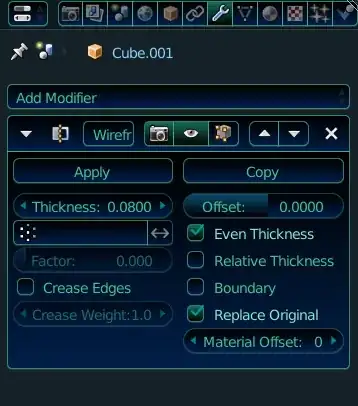

There is a simple way to create a glow effect in Cycles.
  1. Add a cube.
  2. In the material section, Choose "Transparent BSDF" or "Glass BSDF" as the surface and the colour of your choice.
  3. Select "Emission" in the volume and choose the colour as white.The strength can be of your choice
  1. Add a place below the cube
  2. Add another cube and scale it up slightly by pressing S and dragging the pointer.
  3. Make the colour of the cube black and choose the surface to be "Emission"
  4. Go to modifiers, chose wireframe, edit the thickness to your liking.
  1. Place the wireframe over the cube and then Render.It should look similar to the example below:
