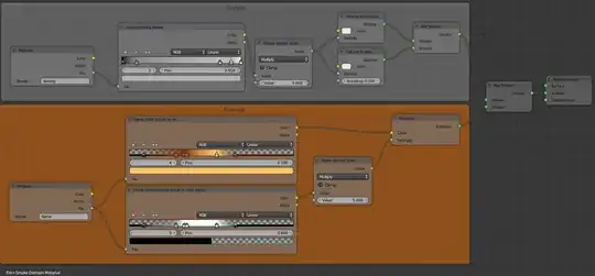

To convert a BI fire simulation volume shader to cycles, you don't need to change the simulation itself (domain physics settings). Just change the engine from BI to Cycles. Then Change the domain material to nodes, using the same color ramp (position, hue, saturation, value, alpha) for color. I doubled the emission (5 in BI, 10 in cycles). Don't forget to convert the light to nodes (there is a point light that has an effect on smoke)
cycles-BI compare
This is the fire+smoke cycles material, with some tweaks (frame 81). Final cycles material
The B&W flame color ramp uses the alpha from color as value.
The "density" is used for smoke density (voxel data) and "flame" for fire density.
The color attribute is not used here (white volume shaders) because the simulation uses only 1 smoke color. This attribute controls the smoke color and is useful when you have 2 or more smoke emitters with different color to get the color mix in the simulation.
frame 81 cycles

  • You'll notice i've also changed the step size, but it increases render time. I'v also changed the corresponding max step to the lowest possible value. – Bithur Oct 26 '16 at 04:38
  • @OldMan In render settings, steps are kind of depth layers (or depth resolution). Step size is the depth of each layer and max step is the max number of layers the render will go through. More max steps (higher number) and thinner layers (low number) will make your volume render more precise at the cost of render time. – Bithur Nov 21 '16 at 16:55
