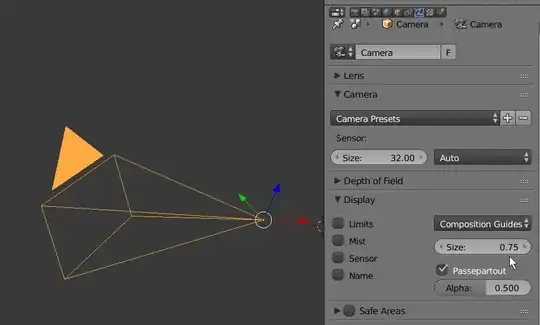

Another option is to simply scale up the camera object. It doesn't effect the FOV at all. Select the camera, go to the properties panel and Camera > Display > Size.
scale camera display only
Scale it up until the frustrum covers your painting area. You can see it from any angle. Alternatively you could parent a lamp with a square cone to match the camera frustrum.

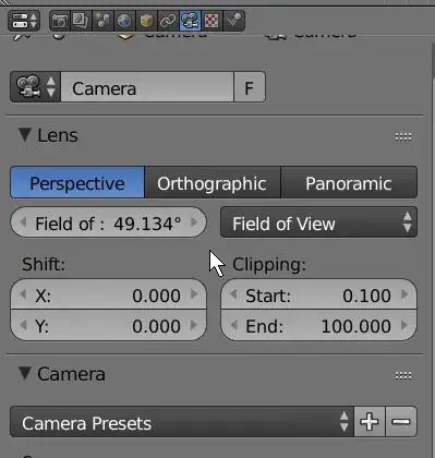

Add a spot lamp and constrain it to the camera and copy the camera's Field Of View to lamp Size. You will have to scale the lamp's Y axis to fit aspect ratio.
lamp constrained to camera
Copy camera FOV
match lamp to camera position and rotation

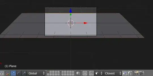

I don't think it's possible as of 2.77, but a quick workaround would be to use Clipping Border to visualize what's visible from camera regarding its field of view angle setup.
  1. Enter camera view (Numpad 0) and enable Clipping Border tool with Alt+B.
  2. Draw the rectabgle which should be the same as camera boundaries.
Now once exiting the camera view you'll see large grey cone of nearly the same area visible to the camera.
GIF of drawing clipping border
Note:
  1. Clipping border means that any geometry out of its boundaries is hidden.
  2. The border drawn may be not the most convenient while in 3D Viewport because of grey area it consists of.
