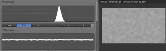

Now simply plugging different texture's Fac output into the Color input of the Background node and pressing F12 to render should produce an analysis of the texture as a histogram. For example, Noise produces the following :
noise
Note : Varying the Scale of the texture node will affect the smoothness of the curve.
For the Noise example above the vertical grid line in the centre of the histogram represents 0.0. Values to the left of this are increasingly negative (with the 1/4 grid line representing -1.0) to the left-hand edge, representing values of -2.0. Similarly, the 3/4 vertical grid line represents 1.0 while the right-hand edge represents 2.0. As can be seen from the graph, the values of the Noise texture centre around 0.5 and vary down to about 0.25 and up to about 0.75. However, there is a 'tail' that theoretically extends indefinitely - presumably down to 0.0 and up to 1.0 but with ever decreasing frequency. So, for practical purposes the Noise texture varies from 0.25 to 0.75 with approximately a normal distribution.

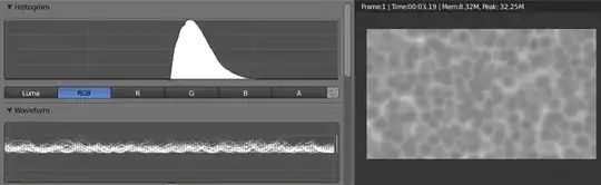

Voronoi - varies between 0.0 and 1.0, biassed towards the lower end and gradually dropping off : voronoi
