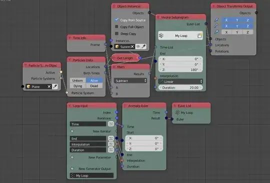

This can easily be achieved by subtracting the birth time of each particle form the time input of the required animation.
Lets assume that your animation is a simple 180 turn around the z axis, then I can just generate the rotations as follows:
Node tree
What happens is when you subtract the birth time of the particle, the time of the animation becomes zero at the time of its birth and it linearly and continuously increases. Other complex and advances animations and scenarios can be achieved on the bases of the previously described concept.
Appendix
In case you don't know how to make a group like particle system, here is a simple a node tree that does exactly that:
Node Tree 2

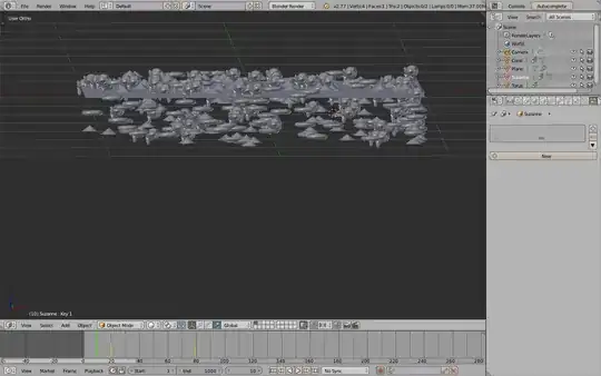

Using texture to birth the animation won't affect the ability to change when the particle emission starts. Here the marble texture is used.
On another layer there is a group of objects which change shape from frame 20 to 80.
Since the default particle animation starts at 1, but our grouped animation starts at frame 20, the emitted objects will not "start their animation sequence when they are emitted from the emitter".
To remedy this, we can change the particle start (found in Properties>Particles>Emission) to 20 as well. In this way our animation will start as the emission starts.

  • Thank you for your work. Here is a link to download the file I am working on. The flowers open when they are born thanks to the texture. 160607_TEST_FLOWERS2.blend Password: xa3h3bef https://eshare.yr.com/dl/RArfga5pUS – Christopher Lowden Jun 10 '16 at 16:57
  • @ChristopherLowden What is it you are trying to achieve exactly? It looks like the particles come out and the make half a turn upon reaching full size. – 360ueck Jun 11 '16 at 15:52
  • The point is about animating objects at particle birth. Using the particle texture, I scale each object attached to a particle at birth. If the objects themselves were animated, without the particle texture, the object would be at its animated size at birth. In this case of scaling at the particle birth, the partcle texture solution works but what if you wanted a more complex object animlation? – Christopher Lowden Jun 13 '16 at 07:06
  • So I wondered if it was possible to drive an AN animation using the particle birth as the driver. Or better still, use the AN system to start an object animation at the birth of a particle? I hope that I am clear. Thank you for your interest – Christopher Lowden Jun 13 '16 at 07:06
