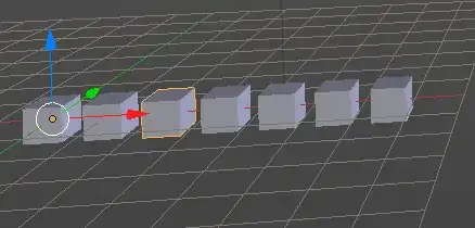

You could use Separate P (in Edit Mode) and select By loose parts.
The reverse operation would be Join Ctrl-J (in Object Mode) this would require all objects selected that you need to join to a single object.
In a script you could select the object by name and invoke the operator:
import bpy
object = bpy.data.objects['ObjectsName']
object.select = True
bpy.ops.mesh.separate(type='LOOSE')
After this you could set an individual origin to each separated object.
This can be accessed from the toolbar or from the menu:
Object -> Transform -> Origin to Geometry
To set the origin in a script you can select all objects and run:
bpy.ops.object.origin_set(type='GEOMETRY_ORIGIN', center='MEDIAN')
