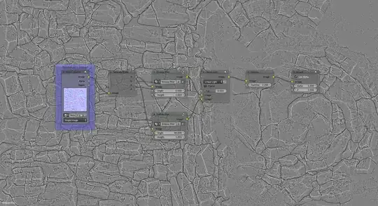

So here is the node setup to achieve the emboss effect, you can download the node setup here: https://drive.google.com/file/d/18BIzLtwe_27HdtuB2ZZ_lfYCcq3Ym4Qv/view?usp=sharing
The node setup starts the three inputs above. The image is set in black and white and one is inverted.
For the Angle it is converted into a radians in order to works for the value is multiplied by Pi: 3.14159265359 then divided by 180. To define the direction multiplier the X value uses Cosine (the second value doesn't matter, it has no effect) and the Y value uses Sine.
The height is divided by two, because to have a separation of 50 pixels for example you need to move at 25 pixels in each direction. The value is multiplied by the direction multiplier then the X is plugged to the X input of a Translate or Transform node and the Y to the Y input.
The non-inverted image colors must have is translation values inverted and for the inverted image colors the translation values aren't inverted. In the node setup above the top translation has the image inverted and the bottom has the values inverted.
Finally both images are combined with a Mix or Value node at 0.5.
A Gamma node at 2.2 can be added after it to convert the image in Linear like the generated emboss effect of Photoshop. Keep it in sRGB (without the gamma node) to work on it with gradient colors or to overlay it.
