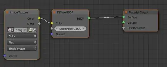

I created a plane and added a Diffuse Material with an image as the texture, and a single lamp above it, using all default settings otherwise. Strangely, the plane appears as black in Cycles. I can't figure out what I could have possibly done wrong.
Do I need to tweak something? (Or is it normal for Cycles to treat a Plane with an image as not being illuminated (if there are no other objects in the scene)?)enter image description here

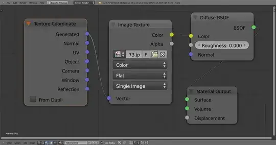

Add some Texture Coordinates! Generated works out of the box, and UV is even better. All pretty standard stuff. :)

    This is most likely the solution. The Image Texture node uses UV coordinates by default, so they must either be created, or Generated texture coordinates must be used. – brecht May 31 '13 at 11:20
  • That was the answer for me and the "Texture Coordinates" is in the "Input " Add Nodes menu, took me ages to find that. – rob Oct 15 '15 at 11:40
