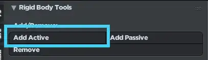

  • Step two is to add rigid body physics. Delete the object on layer one, and move the fractured object from layer two to layer one, or just work on layer two. Select one fracture, go to the tool panel>physics tab and click on add active.
  • Next, select all of the fractures and click on copy from active.

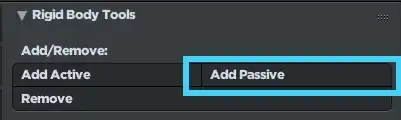

  • Now you need to add a collision object, so that the fractured object has something to shatter against. Add a plane and go to the physics settings in the tool panel again, and click add passive.
Now, drag the fractured object to the height you want it to fall from, and press Alt+A, and something like this should happen:
