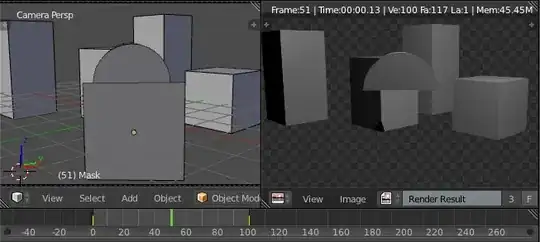

@user277143's suggestion of using booleans would work.
Depending on you needs you could simply leave the circle whole. Then use a masking object, and just animate it moving out of the way.
You just need to have some understanding of 'Render Layers'.
The workflow would be: set up your scene normally, but reserve 2 working layers. One layer for the object being masked, and another layer for the mask itself. Setup 2 render layers, one for everything, and one for the masked objects. Then composite the layers together for final output.
In the example, layer 9 is the object being masked, a cylinder. Layer 19 is used for the mask, in this case, just a plane. The plane is moved out of the way, to reveal the cylinder in the rest of the scene.
masking setup
There are 2 Render Layers, 'MaskedObjects' which renders the scene with the mask in effect. And 'AllOtherObjects' which renders everything normally except the mask and masked objects.
The result of compositing them together:
masking 1
masking 2
masking 3
Just another way of doing things. Here is the file above:
