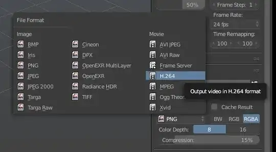

Once you have audio in the video sequence editor, you're halfway there.
So you need to change your render output settings in the render tab
output
Change it to a video format (I normally pick h264)
h264
Then change the wrapper format to Quicktime MOV, and the codec to h264 or PNG if you need lossless quality.
Below that, change the audio codec from none to AAC or MP3 (they're the ones I have had most luck with)
final
And then hit render and it should be in the final render output file (a .mov)
