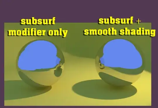

As @Mr Zak pointed out you need to use smooth shading to get cleaner reflections on a glossy material.
The following example should make it clear, both of the spheres are identical, and have the same amount of subdivision (2) on the subsurf modifier
