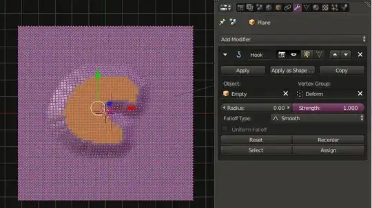

You can't limit the influence of proportional editing to a vertex group. You can achieve this with the hook modifier.
Select the vertices that should be influenced and assign them to a vertex group:
Setup the modifier like this:
This would create a plateau on the top, when you're happy with the border use proportional editing to deform the top to a sphere:

  • Thanks for the fast answer, but that doesn't produce what I need. Your solution gives a flat top, but what I need is a round snail... What I would need is to select the region and only influence this region with the proportional editing – fled Jul 06 '15 at 14:02
  • you could stil to combine both techniques first use the hook followed by proportional editing. Post updated. – stacker Jul 06 '15 at 14:09
  • Hum... The selected region would then need to be smaller then the real object to uprise, since the hook modifyer will drag vertices in the near region... I'll try. By the way, I will add the original picture so you will be able to try for yourself... – fled Jul 06 '15 at 14:21
