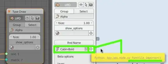

I'm using a font called Cabin which comes in several weights including Bold and Regular and I've loaded those in using the node's properties on the node view rightside panel (press N to view it, with the Typography node selected/active).
If you want multiple font weights for different text elements you simply add a Typography Node and load a font type into it.
Let's take some formatted bit of text, the words to the left of the Pipe symbol | will be bold, and to the right regular. And for the sake of this example i've set their align to be 'LEFT' and 'RIGHT' for either side of the pipe.

The sverchok Typography node is a beast with almost all the features that the regular TextObject exposes via the Properties panel. The node is merely a notification of all that functionality (or what makes sense to me). You can see more options by pressing the "Show options" button on the node, this is incidentally where you can set the align orientation of all text that that node produces.
