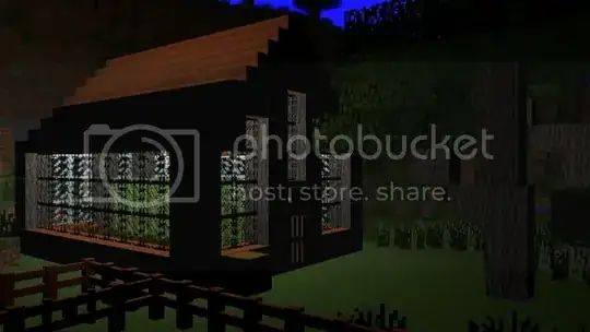

I am trying to render a Minecraft scene generated by Mineways. Quite simply, some of the blocks seem to have transparent edges, as in some cases the "sky" colour (plain blue for now) is showing through while in other areas there are visible "seams" between the blocks, implying that the adjacent blocks are showing through.
In the picture below this issue is most noticeable around the base of the tree in the foreground to the right and along the bank behind the tree (where the blue sky is showing through) and on the logs at the front of the greenhouse (where there are visible "lines" between the log blocks which seem to be caused by the same issue as these lines go away if I turn off the texture's alpha channel). (Don't worry about the weird lighting/shadows - I'm trying to light the scene from inside the greenhouse but have not finished setting up the lighting yet.) screenshot

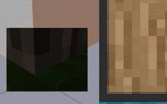

If you look closely, you can see that this is caused texture interpolation getting a little bit of the alpha surrounding the wood texture. So in other words, your wood texture is outlined with a line alpha less than a pixel wide which lets you see through to the objects and sky behind.
This is why you usually want to have a small margin around UVs so interpolation will have something outside with which to interpolate with besides alpha.
To fix this, you can try using the solutions below individually or in combination.
  • Scale the wood UVs in a little so the UVs aren't right up against the alpha:
    This is really a pretty generous margin for this situation. In this case it only needs to be scaled in about half a pixel, but a little extra can't hurt.
    Not completely ideal, as you lose part of the texture (though it's unlikely anyone would notice).
  • Disable interpolation. It won't completely get rid of the problem, as the texture is still filtered a bit when it's distorted by perspective etc, but it will be so small that it's only visible when viewed really close up. This way you can also save some memory by using the 512x512 texture, as it will no longer be blurred by interpolation if it's disabled.

  • I had disabled interpolation and the 512x512 texture is still more blurred than the large version that I included (it is not as blurred as it was before I disabled interpolation but it was still not as crisp as the textures are in Minecraft, but enlarging the texture fixed that). Also I'm not sure that there is alpha around the wood texture, and also the same problem is apparent with the grass blocks behind the tree. – micheal65536 Jun 07 '15 at 13:10
  • @MichealJohnson Did you disable interpolation and set the filter to box and turn the filter size down? – gandalf3 Jun 07 '15 at 17:56
  • No I did not realise that the filter had any significance if interpolation was turned off. I will check it in a moment. – micheal65536 Jun 08 '15 at 12:57
  • I changed the filter and now not only is the bleeding problem gone but the textures are a lot crisper as well. Thanks! – micheal65536 Jun 08 '15 at 12:58
  • @MichealJohnson As I understand it, since the texture is being transformed and skewed according to the angle of the surface to the camera there is still a need for filtering even if no 2D interpolation is done. This should make the 512x512 texture look good too :) – gandalf3 Jun 08 '15 at 18:32
  • Yes I suppose that is why one needs to still have a form of filter, but I had misunderstood the options. I might try the 512x512 texture again, but I have been working on the lighting and camera rig now so I don't really feel like fiddling with the textures again :-) . – micheal65536 Jun 09 '15 at 10:02
