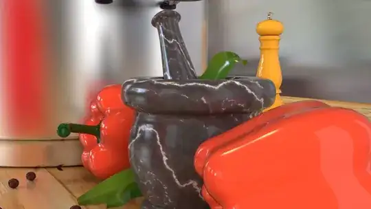

How can I have the pepper look more realistic? I have been trying a few different nodes options as shown below in Cycles, but something still looks like a plastic

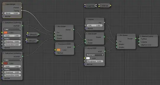

Node with Subsurface scattering:
If I replace the subsurface scattering with Diffuse shader, then I get the result below
It looks better with SSS but requires longer rendering time and more noise. I was wondering if there's easier way to make things work better here.
Overall scene looks like:
Ps. I'd be happy to get any recommendations about how to improve rest of the scene, I know stem is way behind being realisting, its just a plastic looking now :(

  • Well, I'm pretty sure you don't want to mix SSS by a layer weight. I've never seen that done. One thing that might help, is to not have the fresnel so glossy. It really just looks too glossy. I would instead of using a frensl node, take a layer weight node, and use a color ramp or RGB curves to modify it until it looks about right. I would just make sure to keep it less glossy. – TARDIS Maker Jun 05 '15 at 08:03
  • thanks for reply, ok I removed the layered weight and reduced the glossiness and add Layer weight with RBG curve instead of fresnel, i will share a photo once i finish render – ideorium Jun 05 '15 at 08:43

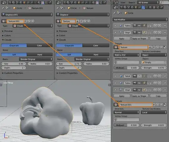

With some hastily slapped together procedural textures, I attempted to simulate these things:
For the irregular shape, I used two displace modifiers. One doing macro displacement in all directions, the other doing subtle displacement along the normals.
To get the subtle variations in color I used a noise texture. For the small nicks I used a bump map. For the rough reflections I used a much rougher glossy shader.
You'd probably be able to get more realistic results with image textures, but perhaps this will give you some ideas.
In my scene I didn't end up using SSS for the pepper, as with my lighting setup the results were indistinguishable from a diffuse shader (and SSS was much noisier). However this might not be the case in your scene, so keep in mind that thickness and inner geometry matter. Peppers are usually hollow with a core running through the middle, so a solidify modifier and a displaced cylinder in the middle should approximate that pretty well.
