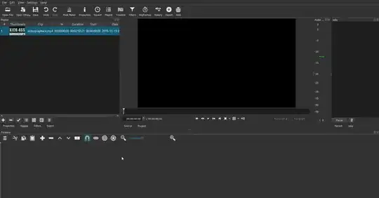

So after a lot of online searching, I did find an answer to fix this problem, but not in Blender. If you are like me and would like to use Blender for video editing and still get around the issue, then I found a workaround, but you need Shotcut for this. Shotcut is another great free and open-source video editor
  1. Export the entire long video from Blender (the rendered video has desync issues as expected).
  2. Open the video in Shotcut and detach the audio from it.
  3. Use the audio properties to make very fine adjustments to the audio playback speed to suit your requirements (make fine adjustments until video and audio are in sync).
Follow the GIF attached. (I am using a shorter video in the GIF but you get the idea)
Explanation
  • Blender has issues while rendering long videos and I noticed that the video is exported at 1.0x speed but the audio is sometimes faster (1.00400x or something like that) and hence the rendered video has audio not in sync with the video.
  • Another bad thing is that Blender does not really allow very fine playback speed adjustment just to the audio.
  • One trick is to adjust the pitch of the audio in Blender which in turn changes the playback speed but this is only allowed up to 2 decimal places (not what we want for long videos) and it makes the audio sound funny (since it actually changes the pitch).
  • Shotcut is a great tool that allows fine playback adjustment, and it also has a pitch compensation feature so that your pitch is kind of unaffected (since we don't want the characters to be sounding funny in our edited video).
  • Shotcut allows playback speed adjustment up to 6 decimal places.
