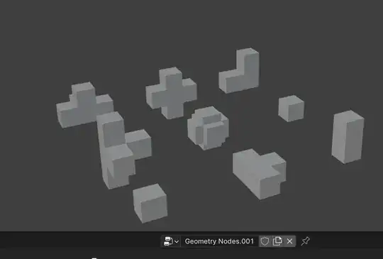

Here is the main Node Here is the main Node Here the NodeGroup Here the NodeGroup here is the result, which unfortunately is not correct, or rather, not the way I would like it to be here is the result, which unfortunately is not correct, or rather, not the way I would like it to be I think the switch with the TimeFrame is unnecessary, we can remove it. I think the switch with the TimeFrame is unnecessary, you can remove it.

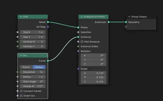

an example is this:
Note: of course instead of the arc there could be your custom node group you made yourself. Problem is, that you cannot change the input values here via instance on points because they are round (no field values), but you can solve that problem via repeat zone like this:
result:
Update for your face selection:
you can try this:
result:
