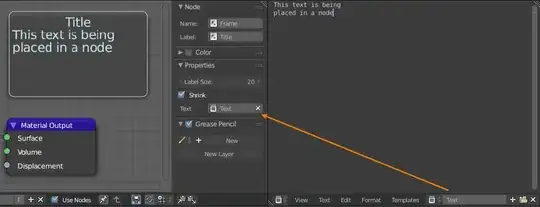

As of 2.74 you can display a text datablock in a frame node:
It's still quite limited, but at least it's somewhat possible now.
