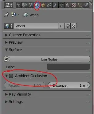

Thank you all for your help!
Apparently there was something wrong with the "Ambient Occlusion". Very strange.
Initial settings 'World'
Result intitial settings and node settings
(so, solid shadows ==> not good)
Change 'World'-settings
==> put 'Ambient Occlusion" ON and OFF again
It worked!
Thank you!
