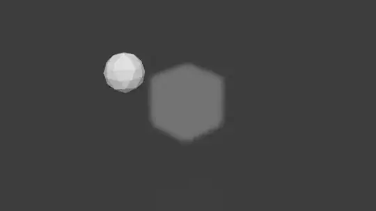

We should probably ask - What did you try and where did you fail ... :)
Smoke Simulation
Like in my comment simple smoke sim seems to handle your needs ...
Vector visualisation ...
Here is a slice on Y axis where you can see what I mean by -no backflip turbulences ... smoke reacts on collider movement but not exactly as in a real world ... part of vorticity is missing ... but like I mentioned for your purpose it could work ...

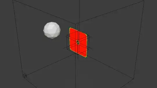

... or you can add another Force Field parented to Collider (mentioned by Chris if I understood it right :) )
So I have to ask again - What is the specific reason you need particles. Probably add some more screens or mockups to express better what didn't wok for you and what specific effect do you expect. Thank you
Smoke Simulation used for Force Field > Fluid Flow
Here is example with Particle system driven by Fluid Flow Force Field issuing smoke sim ...
