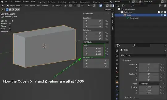

Just beginning Blender learning
In Layout, Edit Mode/Orthographic, I can see after changing the cube to a rectangular shape (looks like a shoe box lid), using Cube>Transform>Scale X,Y,Z to 0.5, 12.o 6.0 (changed from metric to Imperial) consecutively. But after I use letter A to show dimensions, all dimension are 12".
I need x=4", Y=12" z=6"
And even when I scale the measurements do not change. I realize I'm missing a detail that several videos aren't covering or I'm not absorbing

  • Have you tried applying the scale? Object > Apply > Scale – SiljeLB Jan 26 '23 at 19:15
  • @siljelb Yes as I originally stated " using Cube>Transform>Scale X,Y,Z to 0.5, 12.o 6.0 (changed from metric to Imperial) consecutively. But after I use letter A to show dimensions, all dimension are 12"" – Invent-A-Thing Jan 29 '23 at 16:31
  • but further after entering size dimensions in Cube>Transform>Mode>XYZ Euler, all dimensions show as 12" when I actually had put it in as X 0.50"x Y 12.0 x Z 6.0 thinking these would get me inches. Hopefully this is clearer. – Invent-A-Thing Jan 29 '23 at 17:00

Because you scaled your original Cube object in Object mode the mesh is still showing the original dimensions in Edit mode. To correct this, in Object mode you need to Apply the X Y and Z scale. See screen-shots below :
Not sure why my default cube is 24" X 24" x 24" when yours is 12" but doesn't matter for this example : enter image description here
Resizing the Cube in Object mode: enter image description here
In Edit mode the mesh is still indicating the original dimensions : enter image description here
To fix this we need to Apply the Scale in Object mode : enter image description here
Now Scale is 1.000 in Object mode : enter image description here
and dimensions correct in Edit mode: enter image description here
To avoid this issue, best is, whenever possible, do all your mesh editing in Edit mode.
As a general rule always check that your objects scale (in Object mode),is at 1.000 before using Modifiers and UV unwrapping etc.)
A video that attempts to explain this Object mode v Edit mode thing in Blender : https://www.youtube.com/watch?v=xsXSXnMpT9A
The keyboard shortcut to open the Apply menu is Ctrl A
