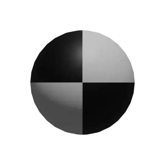

Here I have an example emitter mesh to show what I mean. Emitter mesh

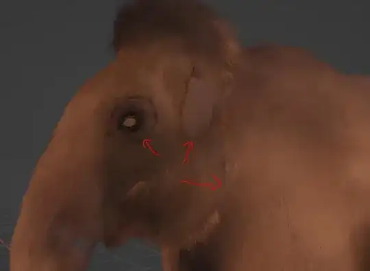

Here's an example of the resulting issue. In the UV seams of the emitter model, we get these black rings, which is problematic. Example mammoth
