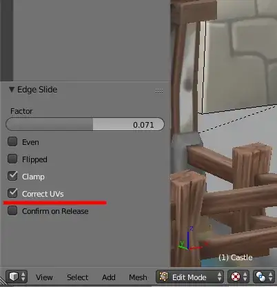

When moving edges/vertices (with g+g) check "Correct UV" in options shelf enter image description here
Or press G three times.
See: https://www.youtube.com/watch?v=aUjbmlgxhXk which shows an example
