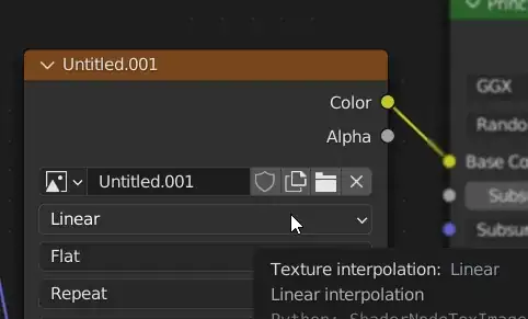

By default, texture nodes have an interpolation so that eventual low resolution textures don't look too much blocky from close distance:
interp
Set it to closest to remove any interpolation:
closest
For your other issue, that seems unrelated. Please write another post giving more detail about it and providing an example file with packed textures so that people can investigate.
