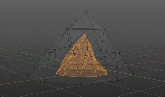

I can't come up with a technique how to do this. I tried to create a conus and randomize its verticies, but I got this:

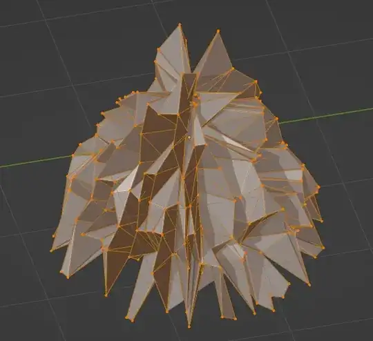

I tried to subdivide the conus and use proportional editing to get rock shapes, but I got a strange looking result. The only way I see it is to create a few rocks and place them in a heap, but it's too long for me. I thought about physics simulation, but in that case I won't get the required shape, and I suppose it's overcomplicated. How can I do it?

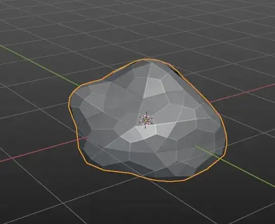

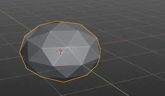

Start with an Icosphere with one level of subdivisions. Maybe scale it down on one axis to make it more squat.
Add a displace modifier with an empty object as the coordinates and a cloud modifier as the texture. Default settings on the texture work fine. Play with the displace strength.
Then add a subsurf,
and a Decimate with the method set to Planar. Crank the degrees up pretty high (like 25 or so)
If you want to leave it here for a more cartoony look you can, or
You can Remesh it, Smooth it and then Displace again if you want to build on the level of detail. Repeat the process as many times as you want or your computer can handle.
Once you get something you like you can duplicate this object as many times as you want with free variation.
Put those into a collection labeled "rocks".

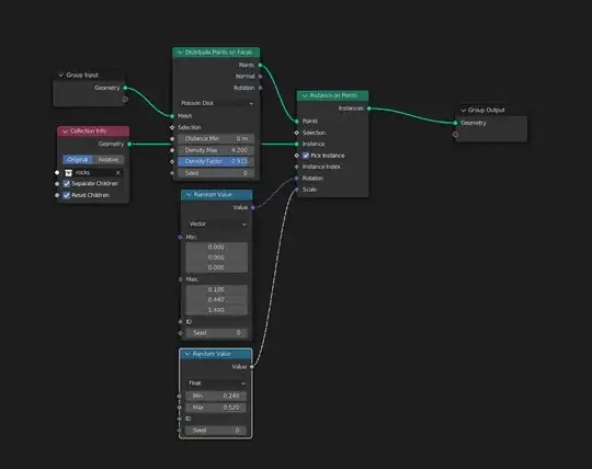

Then add a geometry nodes modifier to this mound object. And give it a setup like this.
Most of the values on each node, you just play with til it looks right.

  • @Jakemoyo i noticed u used an icosphere. does it produce a better result than using a cube turned into quad sphere? – Harry McKenzie Aug 28 '22 at 17:29
    @HarryMcKenzie for some reason yes. I think it has to do with the way a Cloud Displace works on a plain icosphere, since each plane has to stay planar it lends itself toward more rock-like results. – Jakemoyo Aug 28 '22 at 18:24
    You can see the difference here. It's definitely possible to get the same effect with either/or but I think an Icosphere get's you there with less hassle. – Jakemoyo Aug 28 '22 at 18:27
