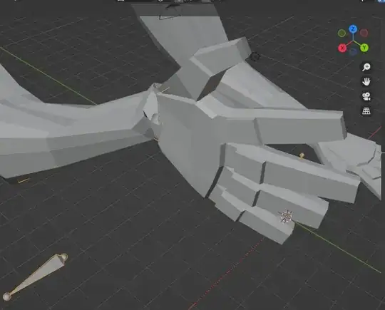

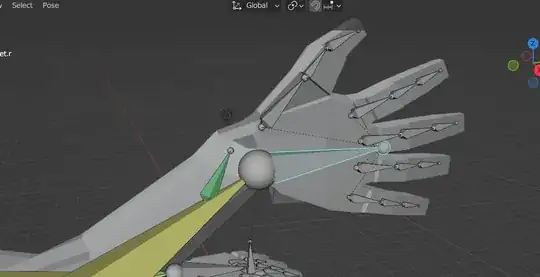

I am having a lot of trouble getting a wrist to twist correctly. My bone setup is thus: Forearm > IK palm bone, with a wrist twist bone that has the forearm as a parent and inherits rotation from the IK palm bone. The palm cannot rotate without ruining the wrist. I have tried removing weight paint from the forearm, and moving around the bones in edit mode, but it remains broken. Bone Setup Broken wrist

    A common technique to get a natural twist of the limbs is to subdivide the bones. This way you have 2 upper arm bones, 2 forearm bones, and so on. The two bones can both rotate to a certain degree, allowing the hand to rotate almost 180 degrees. Rigify does this and you can build your own rig like this. – Blunder Aug 03 '22 at 09:45
  • Thanks all, I was able to make it work using Rigify per @Blunder's answer. Very good addon. – CaptainGloom Aug 04 '22 at 13:56
