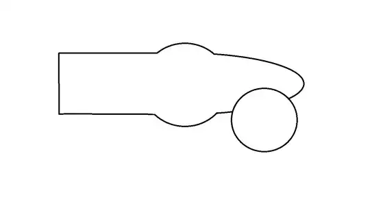

I am working on the cannon below:
The cannon in the 3D Viewport
It is going to be used in a Christmas mobile game and is going to shoot presents. I want to make it have an animation where, when I shoot the present, it's a kind of cartoon-like animation where the present goes through it visibly. It's hard to explain, so I did a little visual explanation:
Cannon before firing
canon with bulge near back
bulge is now farther forward
bulge is at the mouth and cannon ball is visible exiting mouth
What is this kind of animation called, and what are the tools to do it?

You can use a Lattice modifier:
Create a lattice, scale it in Object mode, subdivide it a bit:
Give your cylinder a Lattice modifier with the lattice as Object, select the lattice, switch to Edit mode, edit the lattice so that it deforms the cylinder:
Animate the lattice obect:
