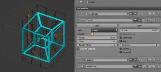

Another way is to use combination of modifiers:
  1. Create a plane, offset its origin;
  2. Hook the whole plane to a new empty object (CtrlH);
  3. Add a Screw modifier, set step to 4, rotate the two objects 45° along global Z;
  4. Add a Lattice, which is used to tweak the shape;
  5. Add a Wireframe modifier;
  6. Animate by rotating along local X (or Y, Z) of that empty object.
Example File
