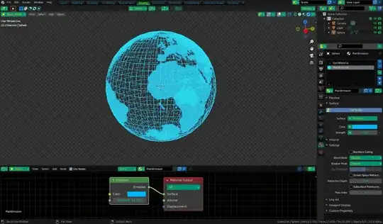

I made this kind of HUD Earth with the shading tab.
I want to add an overlay with latitudes and longitudes, to make it look like a more real-looking HUD Earth. For that, I use the modifier "Wireframe" But when I do it, the longitudes and latitudes kind of replace the continents and don't go in the oceans, it literally replaces all my work, all my continents.
That's not what I'm looking for, I just want the latitudes and longitudes to overlay the landmasses, no to replace them. I'm sure there is a simple way to do that, but how?
Thank you for anyone with the answer to my question.

Un-check the box that says Replace Original on your Wireframe Modifier settings. If needed, you can also add additional material slots to your object and change the material of just the wireframe (or surface) by changing the Material Offset (if, for example you want the latitude/longitude lines to be black instead of the surface color, give the second material slot a black material and change the Material Offset to 1).
WireMat
EDIT - Based on the desired result you outlined in the comments, I would definitely recommend the Material Offset method. Use the "Earth" material for the primary mesh material, and just copy the Emission shader and use that alone as the basis for the second material. Then, just change the Material Offset to 1:
2Mat

  • It kind of worked.. But why are my longitudes and latitudes transparent (longitudes and latitudes=lines from the wireframe modifier)? Shouldn't they be affected by the shading tab and the material like the reste of the sphere? I want them to have the same material and be blue like they should but they aren't. IMAGE: https://imgur.com/a/Lo1Hk1B – Codem Jul 28 '21 at 01:41
  • You're using UV texture coordinates, which won't properly map the texture until you apply the modifier (because the wireframe part of the mesh to apply the UV coordinates to isn't technically "there" yet). You can either apply the modifier and UV unwrap again, or use a second (non-transparent) material and the material offset method I mentioned above. If you are using eevee, try adjusting your materials blend mode if the problem persists. – Christopher Bennett Jul 28 '21 at 01:51
  • I edited my answer with what seems to be the best solution for what you're after. – Christopher Bennett Jul 28 '21 at 04:11
  • I still have the exact same problem, even after simplifying my shading Here's the screenshots: https://imgur.com/a/9p7agOb – Codem Jul 28 '21 at 10:18
  • Ok now I think I solved it thank you, I didn't understand what you mean by "offset". I still have a few settings to correct though – Codem Jul 28 '21 at 12:19
  • @KOΛLΛ_NET21: i added a blend file to the solution of Christopher so you can check it out. If you still have problems, please provide your blend file so i can help you – Chris Jul 28 '21 at 12:40
  • thank you! I did the project all over again, and when I had a problem I just checked on your project I had downloaded. Very convenient – Codem Jul 28 '21 at 16:09

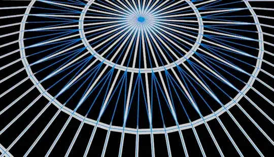

You could just use a setup like this...
...Except for the top and bottom, where the UV unwrapping is not just a grid:
(blue lines above show the wireframe from Christopher's solution)
Which hints this might be the XY problem. The X problem is how to draw the meridians and circles of latitude, which you actually mention in your question; the Y problem is adding a wireframe modifier to your setup, which unnecessarily increases geometry (unless e.g. you want to add like thickness to the lines seen on the silhouette).
Generating longitude/latitude lines in the shader:
Wireframe is blue below while the shader lines are white:
Notice how lines created in the shader aren't even - you could make them using trigonometry, similarly to e.g. this answer: How to add golden line to my maps?
Update: here's a setup with constant thickness of the lines:
I had to double the Value node describing the number of horizontal circles, not sure why and didn't bother to count if it's correct now or was correct before.

  • I tried your first setup, the latitudes and longitudes didn't appear. What did I do wrong? :( screenshot: https://imgur.com/a/XmMKIVR
    By the way I really like the way you compact your boxes and only show the relevant values, don't know how you did that but that's pretty neat. If there's any way for me do that too I'm interested
    – Codem Jul 29 '21 at 00:30
  • @KOΛLΛ_NET21 Math > Compare node outputs 1 for any value not more than Epsilon away from 2nd value. So increase the Epsillon to something significant, .e.g. 0.1 for 10% of the space to be white (if you put 0.1 as ε in both compare nodes, you will take 10% of area once, and then also 10% of 90% of remaining area, totalling 19% of sphere surface to be taken by lines). Also take a look at the top-left Texture Coordinate node, I'm using Object space there. https://i.imgur.com/2I513g4.png – Markus von Broady Jul 29 '21 at 08:10
  • @KOΛLΛ_NET21 as for making the nodes compact: I move them with CTRL and keep exactly 2 grid cells between them horizontally (less and you have problems connecting nodes), after nodes are connected, I also temporarily connect something to unconnected inputs with their default value changed, select that node, press CTRL+H, disconnect temporary links. You can also right-click > toggle node options. And of course you can resize your nodes. The best thing you can do, however, is CTRL+G, but I avoid it on Stack Exchange because then you need multiple screenshots. – Markus von Broady Jul 29 '21 at 08:18
