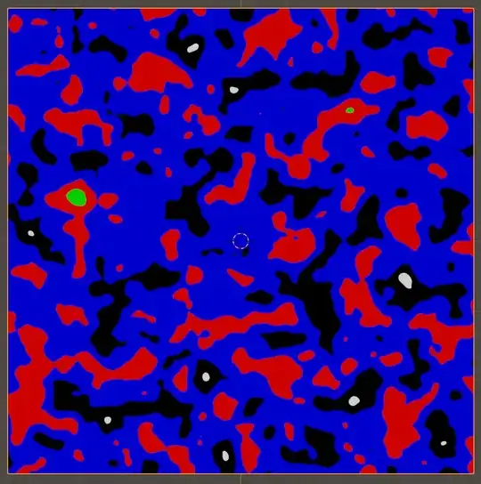

Though I have been using the ColorRamp node for quite a while, I often trial and error moving the handles in the ColorRamp node around to get my desired effect. I realized that I didn't really have any intuition about how it worked, I just 'did' things until it worked the way I wanted it to. I figured its best I try to think about what it 'logically' does behind the scenes, but I can't quite understand
For instance:
Here this is equivalent to plugging the Noise Node directly into the Material Output/Viewer. I understand the Noise Texture is a psuedorandom texture that is PURELY greyscale, that is colors can be black, white or anything in between
Here:
I assume it is different here. From what I believe, this setting of the ColorRamp handles basically mean: "Since the lefthandside of the ColorRamp 'strip of colors' is wholly black, this means that any colors in the Noise texture that is darker than grey (since I assume grey is in the middle of black and white, and the black color handle here is right in the middle) are to be treated as completely black"
For this one:
I assume its the same as before but flipped. Anything LIGHTER than grey from the noise texture is outputted as completely white, though I am confused, since they look more grey than white to me
However, this one confuses me:
Anything darker than grey is to be treated as pure black, anything lighter than white is to be treated as pure white? What about the small gap between the black and white handles? What do they logically mean?
Finally, using it with a MixShader:
How does this work at all? From my limited intuition, this basically means where there is black on the Noise Texture, shade that area with Red, where there is white shade with Blue, but what about once again the tiny gap down the middle? What's it do here exactly?
All that being said, what exactly am I getting wrong with my intuitions of the various ColorRamp settings, what am I not understanding here?

  • Your intuitions about the color ramp are correct. Your confusion is coming from color management (post-processing on the color, conversion from linear color in nodes to sRGB color for display) and samples (the screen color is the average of every sample, and if there are multiple samples per pixel, pure bw input can turn into grey output.) Do your testing with display device "None" and 1 sample and it will agree with your intuitions. – Nathan Jul 10 '21 at 16:35
  • Also reading the comments, your confusion comes from how the node tree is evaluated on each pixel of the object on the screen, and not once for the whole mesh, which in its own right is a complex question – Gorgious Jul 10 '21 at 16:40
  • @Nathan Display Device None? So if im assuming right, it renders as the colors as the linear colors you talked about? – Hash Jul 15 '21 at 09:26
  • @Gorgious So does this mean node trees are actually calculated per mesh instead of per pixel? – Hash Jul 15 '21 at 09:26
  • @Hash Display device "none" does no color conversion at output. What particular space that is depends on your perspective and doesn't matter; what matters is, no conversion, no delinearization of values. The other thing it does is stop your from using Filmic or related, which will not output 1.0 emission as 1,1,1, in order to let you sometime in the future put a 10.0 emission object into the render and still see the difference. – Nathan Jul 15 '21 at 15:01
  • One thing of the greyish appearance is partly because of Color Management (by default Filmic).
  • Another thing is Noise Texture itself. Using ColorRamp should results as 0 (white) - 1 (black) at some point on texture that is not happening. My explanation is - that these 0 and 1 points are somewhere in texture currently not visible on mesh surface. With simple Linear gradient texture it works fine.
  • All greys up to black handles became black ... all greys up to white handle became white, all the greys between black&white handles are blending from 0-1
  • Mixing colors works in the same way. Color at center is 50% Cyan and 50% Red
  • The same color you can get by Mic node with Fac 0.5

It might be best to think of this in two parts, how the ramp is created and how it is used. Let's take how it is used first:
Using a color ramp
The input to a color ramp is not a color. You can feed it the output of a color node, but internally it converts that into a single number. [If you feed it a color it computes the luminance of that color and uses it.]
In your examples, you aren't feeding a color to the color ramp, because you are feeding it the Fac output of the noise texture, by the way. Noise textures do produce color.
Think of the color ramp itself as being a strip along the X axis from 0 to 1. At any given position on the ramp, there is a color. The color ramp node takes the fac input and goes to the equivalent position on the ramp. Its output for that Fac input is simply the color that is at that position on the ramp. You can think of this as a lookup table.
The handles have nothing to do with this part of the process, nor does Blender's color management. Intuitively it is a lookup table: go to the position on the line that matches fac, and return the color that's there.
Here's a different color ramp:
constant color ramp
On this ramp, if fac is between 0 and .2, pure green will be returned; but if it is between .4 and .6, pure blue will be returned.
Here's the output of a noise texture plugged into the above color ramp:
noise texture
Creating the ramp
This is where the handles come into play. Rather than having you create a color for every possible position on the ramp, Blender interpolates between values using mathematical formula. The start and end values are set by the handles, and the interpolation method is set by the control that is set to Linear by default:
color ramp interpolation options
There are several ways to interpolate colors between handles, and I won't go into details.
What do the gaps mean?
They mean whatever the interpolation mode tells them to mean. In your example, you are using linear interpolation, so the range between black and white is evenly distributed between the two handles, gradually going from black to white. In my example above, the range is constant.
What about using it as the factor in a mix shader?
Since the color ramp node outputs a color, but the mix shader uses a number, the mix shader internally converts the 3 numbers that make up the color value into a single number in the range of 0 to 1. It then performs its mix operation as usual.
