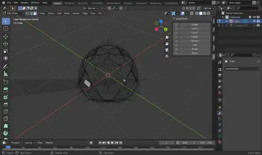

I did something now viewport solid looks like this:
There is a point somewhere out at infinity projected through the shape and the only 2 faces showing are the ones in the projection. Material preview mode looks normal.
What did I do?

You have enabled a Clipping Region (Shortcut Alt + B - easy to do by mistake). You can clear it by pressing Alt + B again.

  • That was it, thanks! I've been learning to use the 'bevel' setting, Alt+B instead of Ctrl+B – S'rCat May 08 '21 at 05:28
  • Yeah, like I said - easy mistake. If you can see from my image though, Ctrl + B in Object Mode will define a render region - make sure you're in Edit Mode if you plan to Bevel. – Christopher Bennett May 08 '21 at 05:36
