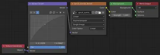

Rather than thinking about scaling or otherwise transforming the World sphere itself, it’s more useful to think about altering the way the HDRI is projected onto the sphere. For example, suppose we use this HDRI for our world lighting, which looks like this using the standard projection:
We can smoothly distort the projection along the Z axis using a Vector Curves node, effectively adjusting the position of the equator:
This produces an image like this:
Note that any smooth reprojection fundamentally distorts different parts of the image differently. In the above example, our remapping of the Z axis stretches the sky and pinches the ground, leading to a curved horizon line. This probably isn’t what you want.

Yes you can. Go into the shader editor and switch to 'world' in the window's menu bar:
selecting world in the drop down
Make sure "Use Nodes is checked. You'll see your HDR world shader look something like this:
simple hdr world shader
You need to add the texture coordinate node and mapping node as shown here:
full world shader
Then you can use the mapping mode to modify your HDR as you wish, within the limits imposed by it being an HDR.
